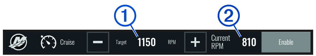

Mercury Cruise Control Overlay
Mercury control bar with callouts
Minus symbol
Select to decrease the target speed
1
Target speed
Plus symbol
Select to increase the target speed
2
Actual speed
Enable
Select to engage the cruise control
Disable
Select to disengage the cruise control
