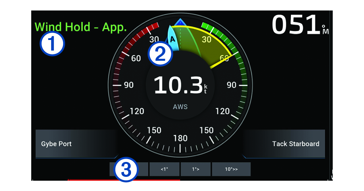

Wind hold autopilot screen with callouts
1
Autopilot status information
Standby and Autopilot status indicator appear in gray when the autopilot is in standby mode.
Wind Hold and Autopilot status indicator appear in green when the autopilot is engaged in wind hold.
2
Wind gauge
Shows the true wind speed (TWS) or apparent wind speed (AWS)
3
Rudder position indicator
NOTE: This functionality is available only when a rudder sensor is connected.
