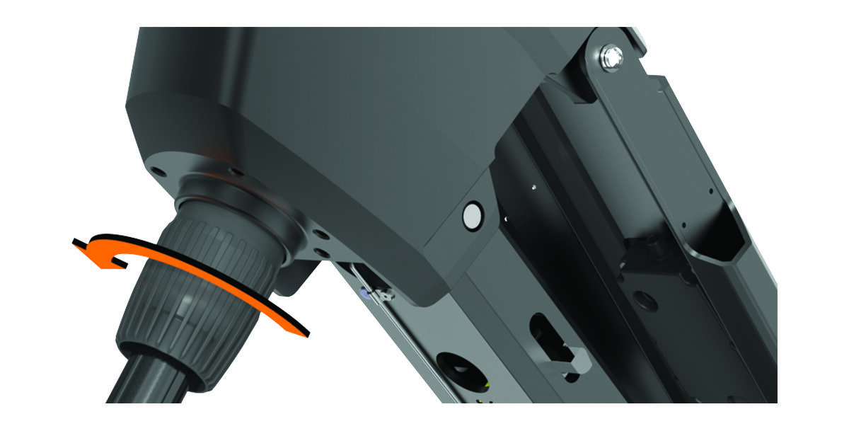

  1. Move the motor so that it stops halfway between the stowed and deployed positions.
  2. Loosen the collar at the base of the steering system housing.
    Depth adjustment collar
    NOTE: You should be prepared for the motor to slide down when you loosen the collar.
  3. Raise or lower the depth of the trolling motor.
    NOTICE
    Do not set the motor depth so low that it compresses the coiled cable. When the coiled cable is compressed, it will be damaged by friction as the motor steers, and may cause unexpected movement when using the anchor lock feature.
  4. Tighten the collar at the base of the steering system housing.
  5. Select an action:
    • If you are deploying the trolling motor, move the motor to the fully deployed position to check the depth.
    • If you are stowing the trolling motor, move the motor to the stowed position to check the depth (Stowing the Motor from the Deployed Position).
  6. Repeat this procedure if necessary to set the correct depth for the deployed or stowed position.
