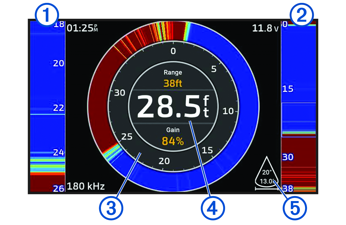

Flasher View
The flasher shows sonar information on a circular depth scale, indicating what is beneath your boat. It is organized as a ring that starts at the top and progresses clockwise. Depth is indicated by the scale inside the ring. Sonar information flashes on the ring when it is received at the depth indicated.
The flasher colors indicate different strengths of the sonar return. The default color scheme follows a traditional sonar color palette, in which yellow indicates the strongest return, orange indicates a strong return, red indicates a weaker return, and blue indicates the weakest return.
Select Sonar > Flasher.
Flasher sonar view with callouts
1
A-scope, zoomed-in view of the right side view
2
A-scope with zoom area outlined 1
3
Depth scale
4
Depth at your present location
5
Angle and span of the transducer cone at the current frequency
1 You can drag the outline to move the zoom area up and down.
