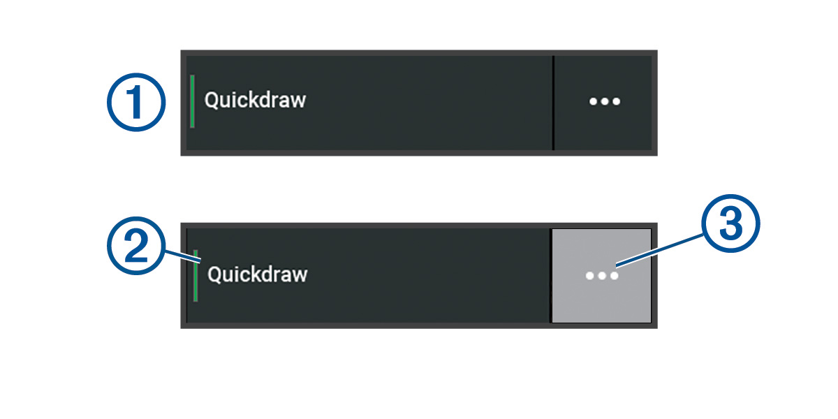

  • On some menu buttons, select the button 1 to enable the option.
    Onscreen button with callouts
    A green light on an option indicates the option is enabled 2.
  • When available, select Menu options symbol 3 to open the menu.
