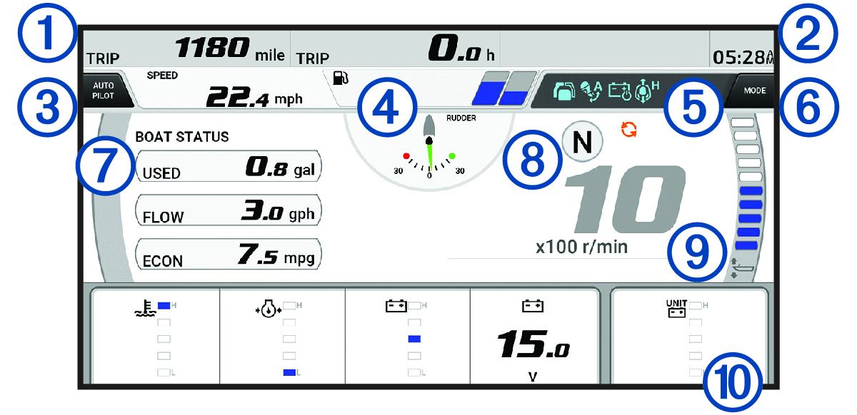

Engine gauges screen with callouts
1
Boat data fields
Hold to replace the data.
2
Current time
Hold to view trip data.
3
Select to toggle the autopilot bar on and off (Helm Master® EX).
Select to set the joystick button for Set Point functions (Helm Master and Helm Master EX).
4
Tank level information or battery level information
Hold a tank or a battery to view detailed tank level sensor or battery level information.
5
Status icons:
  • Blue: engine or motor function indicators
  • Orange: engine or motor status or condition information
  • Red: engine or motor warning and alert information
GPS signal strength (Helm Master)
6
Select to set the Fish Point settings (Helm Master/Helm Master EX).
Select to set the trolling speed (Helm Master/Helm Master EX/Mechanical RC/Digital Electronic RC (6X6/6X7)).
7
Boat data fields
8
Shift position indicator
Engine RPM
9
Tachometer and trim angle
Hold to change the background.
10
Engine, motor, and boat data fields
Hold to replace the data and change the gauge appearance.
