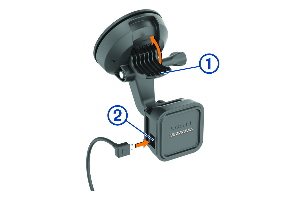

  1. Open the lever Callout number one, press the suction cup to the windshield, and flip the lever back toward the windshield.
    The lever must be oriented toward the top of the windshield.
    Mount and power assembly with callouts
  2. Plug the vehicle power cable into the port Callout number two on the mount.

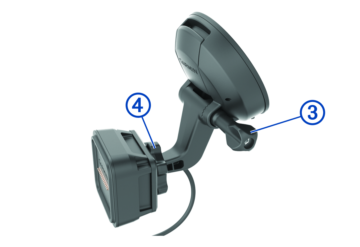

  3. If necessary, loosen the thumbscrew on the suction cup arm Callout number three and the nut on the ball mount Callout number four, and adjust the mount for better viewing and operation.
    Mount assembly with callouts
  4. Tighten the thumbscrew on the suction cup arm and the nut on the ball mount.

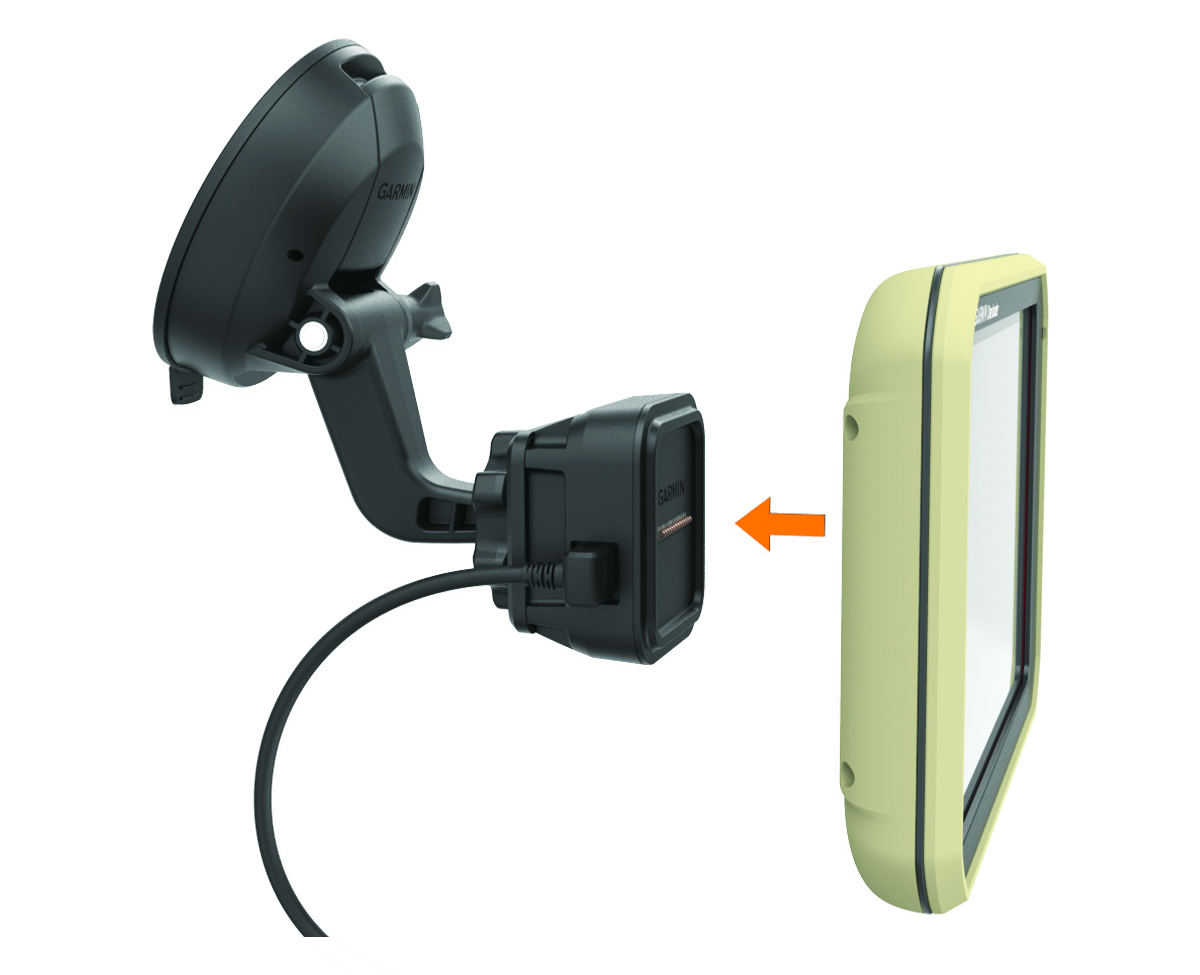

  5. Place the device onto the magnetic mount.
    Device connecting to the mount assembly with callouts
  6. Plug the other end of the vehicle power cable into a power outlet in your vehicle.
