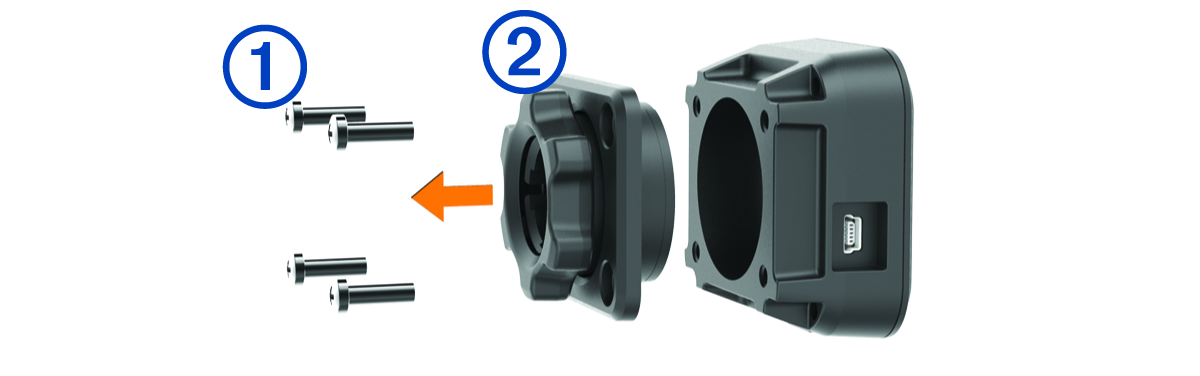

  1. Remove the four screws Callout number one securing the mount socket Callout number two to the magnetic mount.
    Mount adapter with callouts
  2. Remove the mount socket.
