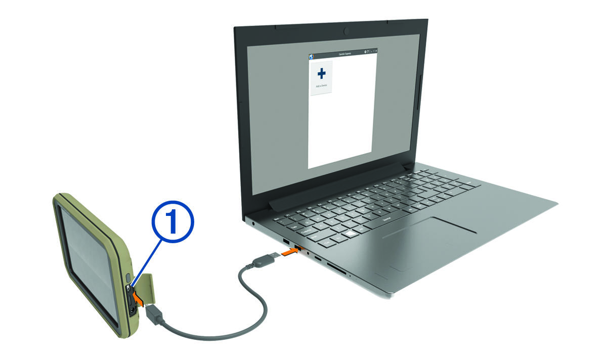

Connect your device to your computer using a
micro-USB cable.
The small end of the cable connects to the micro-USB port
on your Overlander™ device, and the large end connects to an available USB port on your computer.
