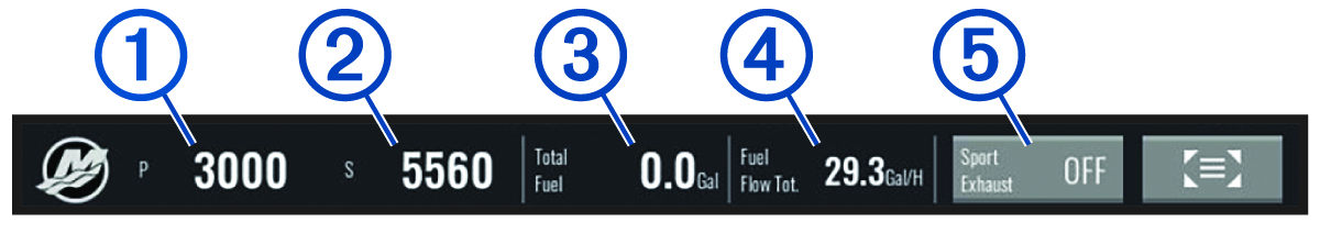

Mercury Engine Overlay
You can use the Mercury Engine Overlay to view engine data (Adding the Mercury Engine Overlay).
Port engine RPM |
Starboard engine RPM |
Total available fuel |
Fuel usage |
Sport Exhaust control (if supported) (Enabling the Mercury Engine Sport Exhaust Setting) |
When your chartplotter is connected to a compatible Mercury engine, you can use the Mercury Engine overlay on the chartplotter to enable the Sport Exhaust setting. The Sport Exhaust setting alters the engine sound.
