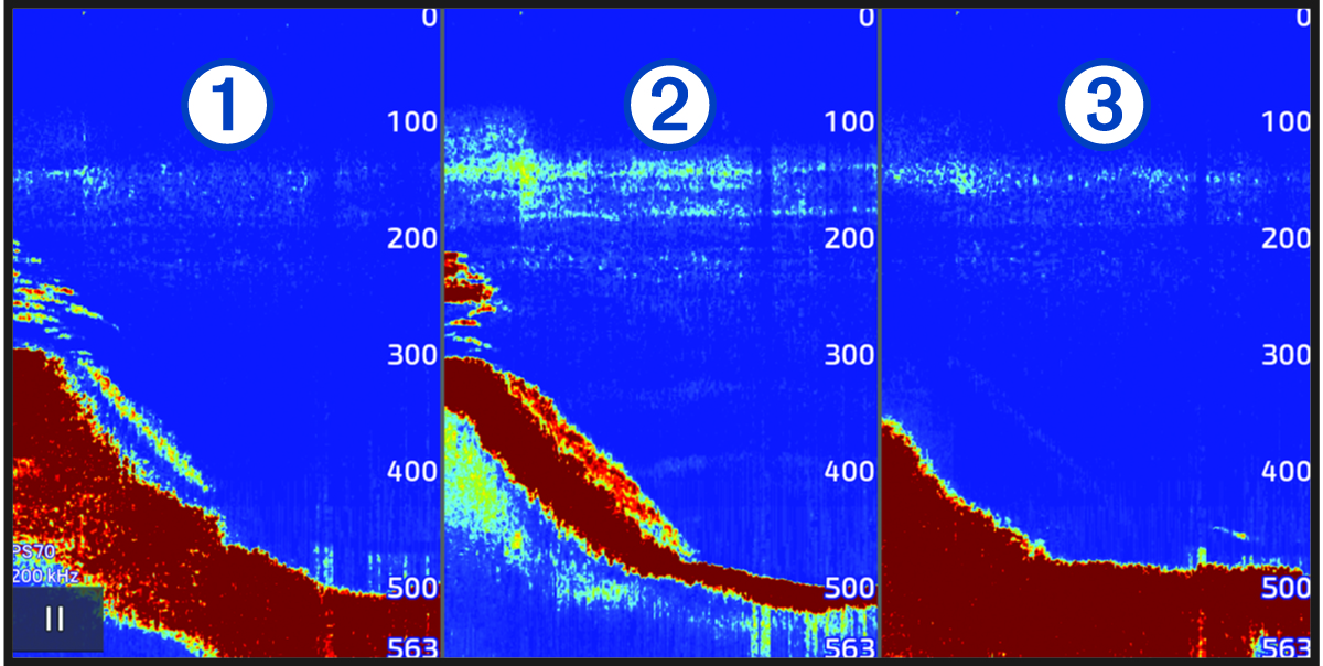

Triple Beam Sonar View
The Triple Beam sonar view is available only when using a compatible transducer, such as the Panoptix™ PS70-TH.
This sonar view shows three traditional sonar views on one screen, so you can simultaneously see separate sonar readings from the port side, the starboard side, and the center of the boat. You can add each separate view to combo pages as needed.
You can adjust the angle and width of the three sonar beams in the MENU menu. Other sonar options and settings, such as the sonar Gain, are synchronized across all three views.
Triple beam sonar view with callouts
Callout number 1
Port transducer beam
Callout number 2
Center transducer beam
Callout number 3
Starboard transducer beam
