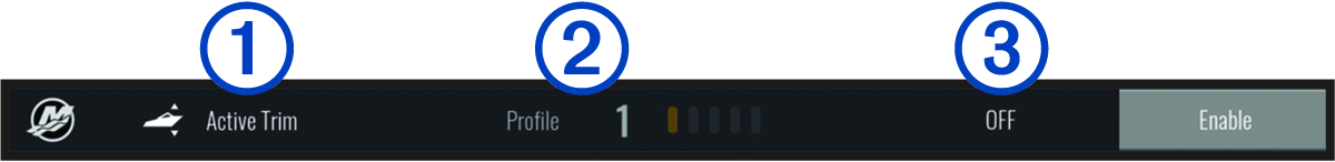

Mercury Active Trim Overlay
Mercury active trim bar with callouts
Callout number 1
When enabled, you can manually adjust the trim.
Callout number 2
When enabled, you can change between Mercury active trim preset profiles.
Callout number 3
Active trim system status.
Enable or Disable
Select to turn the active trim system on or off.
