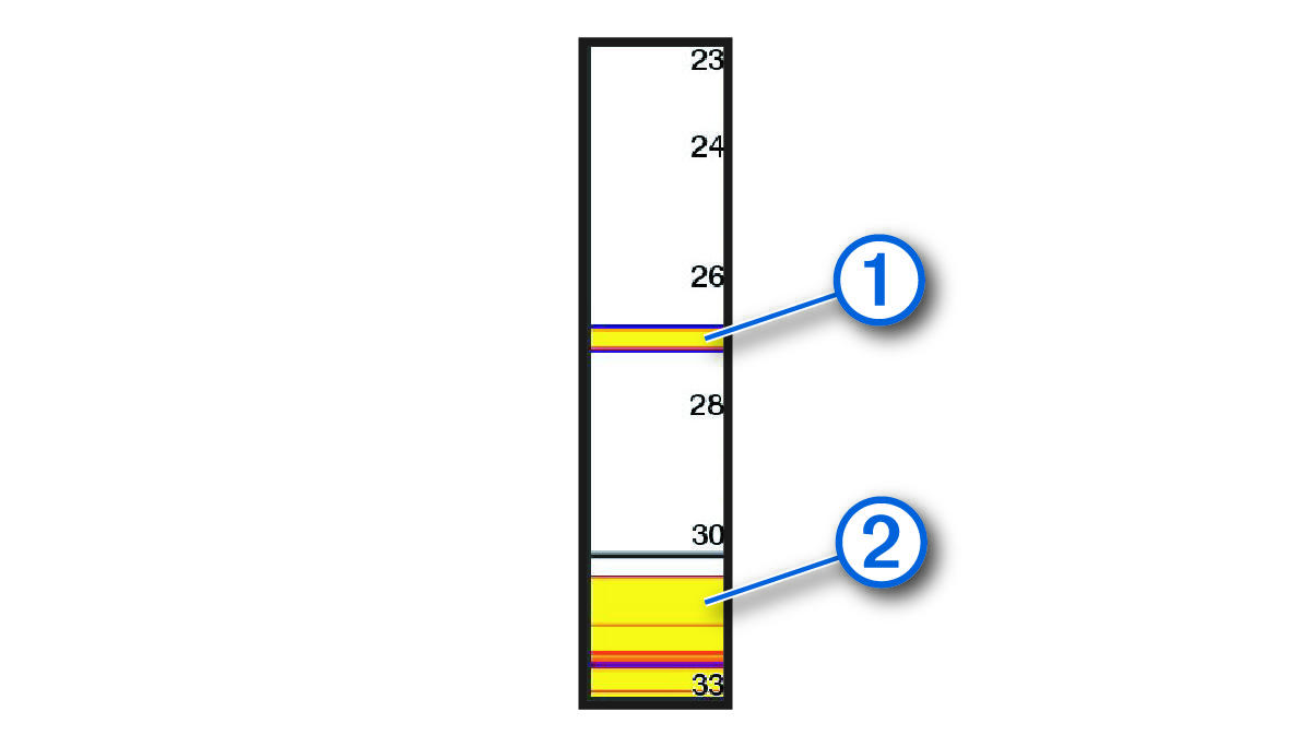

The a-scope is a vertical flasher along the right side of the view, showing you what is underneath the transducer right now. You can use the a-scope to identify target returns that may be missed when the sonar data is quickly scrolling across the screen, such as when your boat is moving at high speeds. It can also be helpful for detecting fish that are close to the bottom.
A-scope with callouts
The a-scope above shows fish returns Callout number 1 and a soft bottom return Callout number 2.
  1. From a sonar view, select MENU > Sonar Setup > Appearance > A-Scope.
  2. If necessary, select Menu button > Peak Hold to adjust the length of time the sonar returns are displayed.
