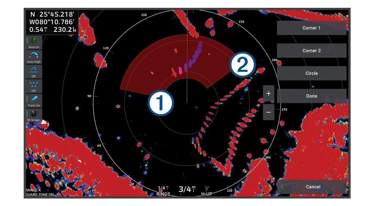

Defining a Partial Guard Zone You can define the boundaries of a guard zone that does not completely surround your boat. From a radar screen, select MENU > Radar Options > Guard Zones. Select Guard Zone 1 or Guard Zone 2, and then select . Use the arrow keys to move location of the outer guard-zone corner . Press SELECT. Select Corner 2. Use the arrow keys to move the inner guard-zone corner to define the width of the guard zone. Select Done. Parent Topic: Enabling Guard Zones
