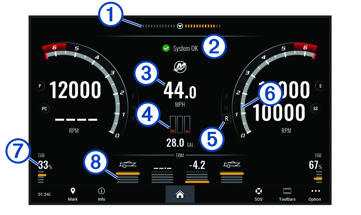

Select Vessel > Mercury to view the Mercury engine gauges.
Mercury gauges screen with callouts
Callout number 1
Engine voltage or Mercury Steering Angle1
Callout number 2
Boat status
Callout number 3
Boat speed
Callout number 4
Fuel
Callout number 5
Transmission gear
Callout number 6
Engine speed
Callout number 7
Trim tabs
Callout number 8
Engine trim

1 The Mercury Steering Angle may appear on the display, depending on the engine model and configuration, and its location on the display may vary.
