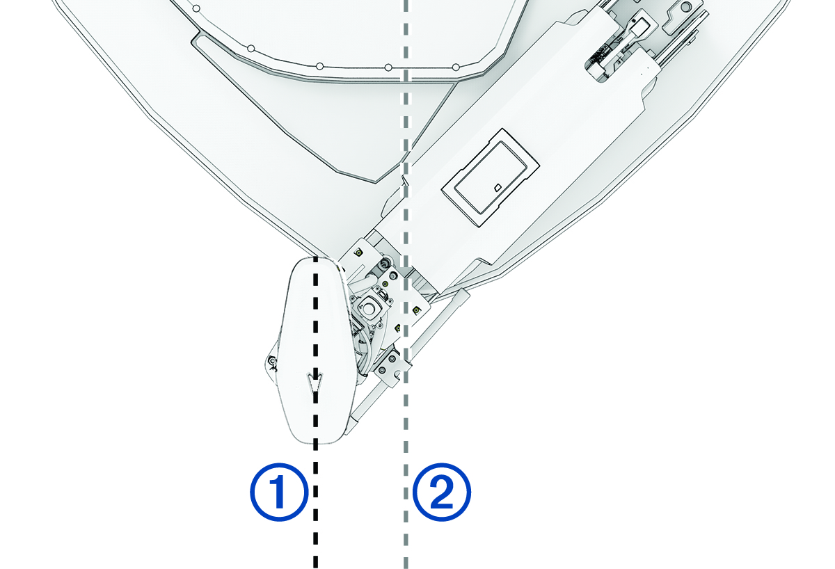

Based on the installation angle, the trolling motor may not align with the center line of your boat. For the best results, you should set the bow offset.
  1. Adjust the angle of the trolling motor Callout number 1 so it aligns with the center line of your boat Callout number 2, pointing straight forward.
    Bow offset with callouts
  2. From the trolling motor bar, select Menu symbol > Calibrate > Bow Offset.
