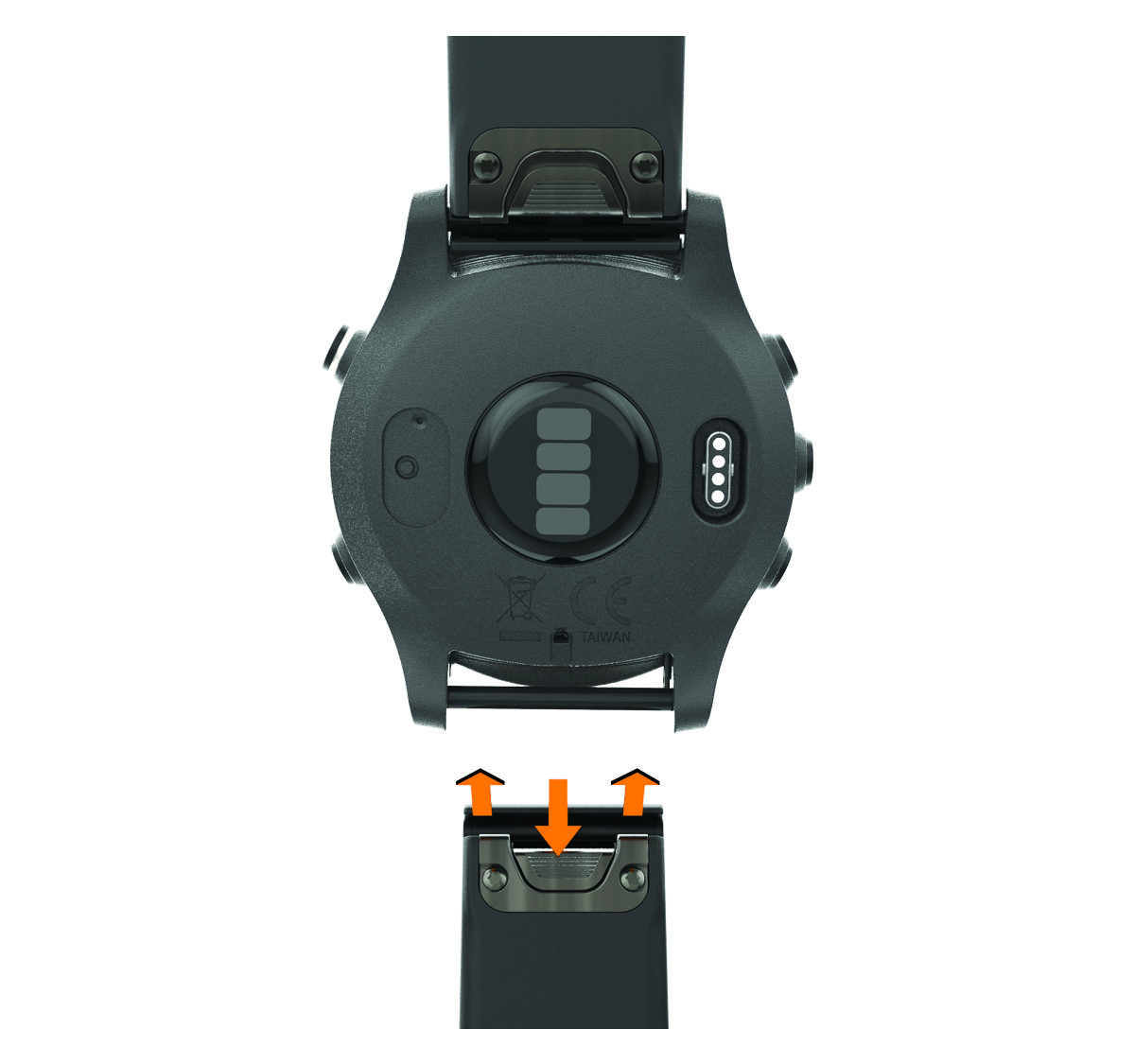

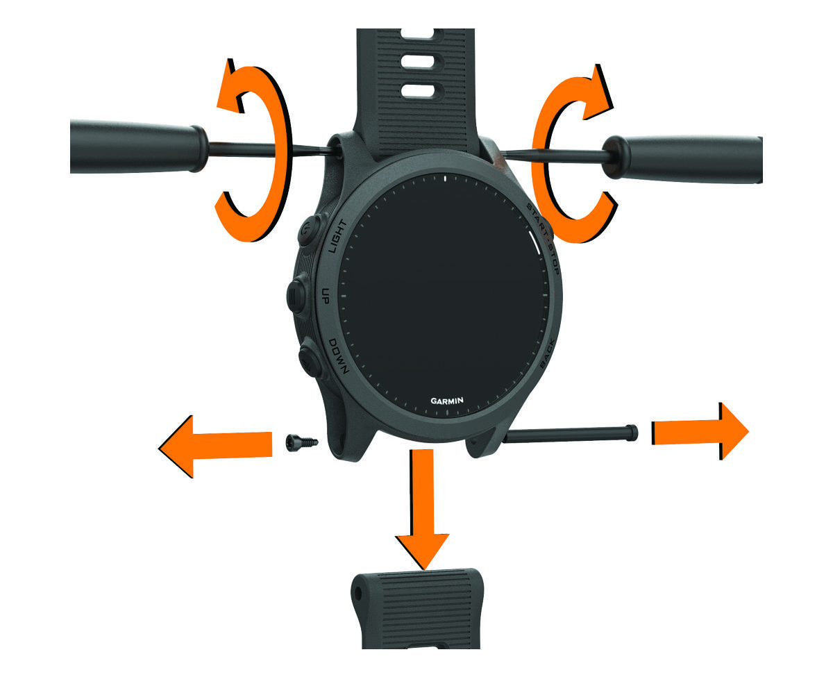

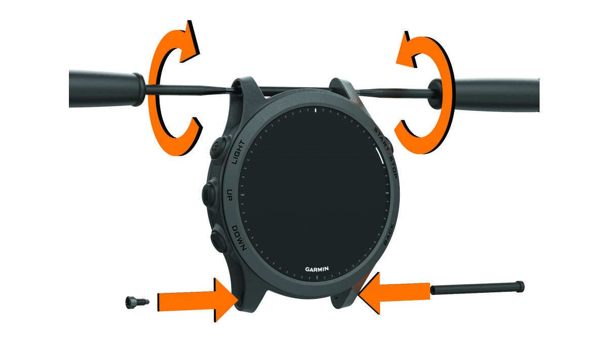

Changing the Bands You can replace the bands with new Forerunner® bands or compatible QuickFit® bands. Use the two screwdrivers to loosen the pins. Remove the pins. Select an option: To install Forerunner bands, align the new bands, and replace the pins using the two screwdrivers. To install QuickFit bands, replace the pins, and press the new bands into place. NOTE: Make sure the band is secure. The latch should close over the watch pin. Parent Topic: Device InformationHomeDevice InformationChanging the Bands
