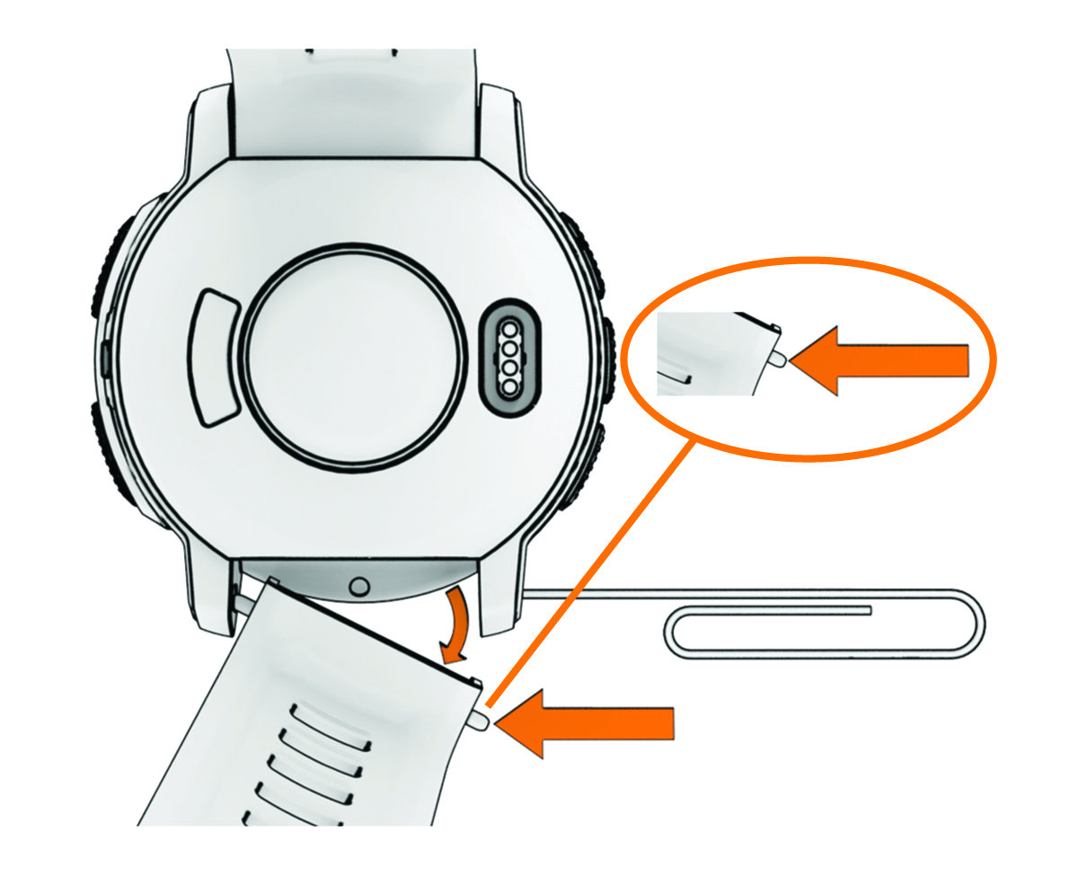

You can replace the bands with new Instinct® Crossover bands or compatible QuickFit® 22 bands.
  1. Use the pin tool to push in the watch pin.
    Replacing the watch band
  2. Remove the band from the watch.
  3. Select an option:
    • To install Instinct Crossover bands, align one side of the new band with the holes on the watch, push in the exposed watch pin, and press the band into place.
      NOTE: Make sure the band is secure. The watch pin should align with the holes on the watch.

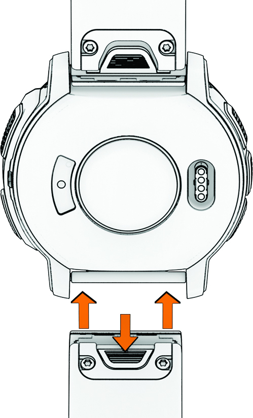

    • To install QuickFit 22 bands, remove the watch pin from the Instinct Crossover band, replace the watch pin on the watch, and press the new band into place.
      Replacing the QuickFit watch band
      NOTE: Make sure the band is secure. The latch should close over the watch pin.
  4. Repeat the steps to change the other band.
