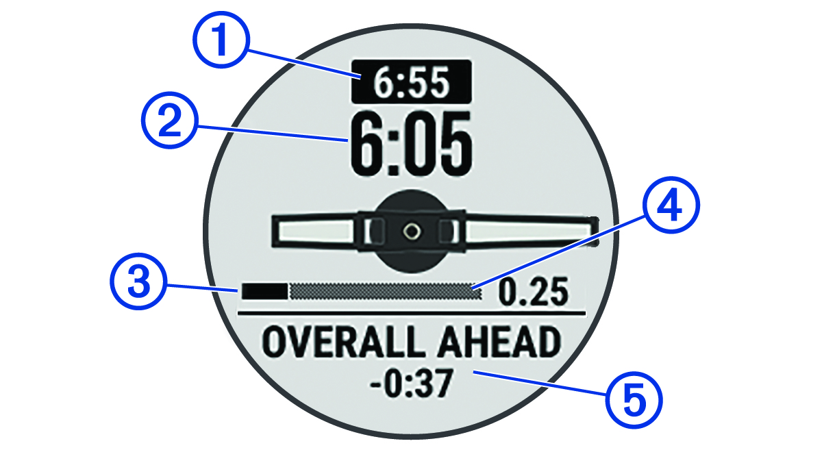

    Screenshot of the PacePro page with callouts
    1
    Target split pace
    2
    Current split pace
    3
    Completion progress for the split
    4
    Distance remaining in the split
    5
    Overall time ahead of or behind your target time
