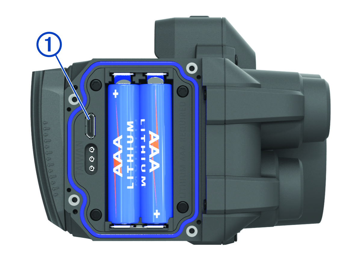

  1. Using a 5/64 inch hex wrench, loosen the four screws securing the battery door.
  2. Remove the battery door, and set it aside.
    NOTE: Do not remove the batteries.
  3. Plug the small end of the USB cable into the USB port Callout number one on the device.
    View of the USB port with a callout
  4. Plug the large end of the USB cable into a computer USB port.
  5. If the bow sight is turned off, press Back symbol to turn on the device.
    The bow sight enters USB mass storage mode.
