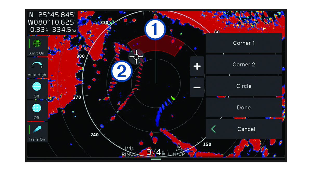

Defining a Partial Guard Zone You can define the boundaries of a guard zone that does not completely surround your boat. From a radar screen, select Options > Radar Options > Guard Zone > . Drag the cursor to the location of the outer guard-zone corner . Select Corner 2. Drag the cursor to the location of the inner guard-zone corner to define the width of the guard zone. Select Done. Parent Topic: Enabling a Guard Zone
Defining a Partial Guard Zone You can define the boundaries of a guard zone that does not completely surround your boat. From a radar screen, select Options > Radar Options > Guard Zone > . Drag the cursor to the location of the outer guard-zone corner . Select Corner 2. Drag the cursor to the location of the inner guard-zone corner to define the width of the guard zone. Select Done. Parent Topic: Enabling a Guard ZoneHomeRadarEnabling a Guard ZoneDefining a Partial Guard Zone
