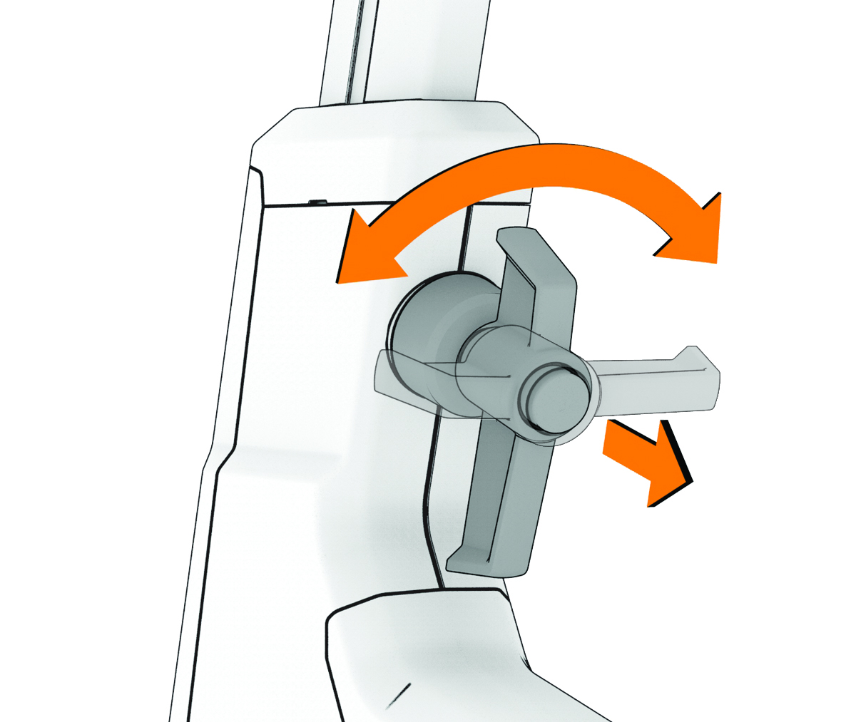

  1. Confirm the bike geometry, and select an option:
    • For the handle bolts, firmly tighten each handle by hand.
    • For the set screws, firmly tighten each screw using the 6 mm or 8 mm hex keys.
  2. For the handles, pull and turn the handle only (the bolt doesn't move), and align it to the frame or rail.
    The handle itself has a spring mechanism that can be snapped into alignment with the bike so it doesn't stick out or get in the way.
    Handle with alignment arrows
  3. Make sure the handle snaps back into place.
