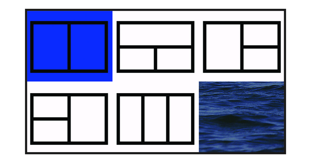

Creating a New Combination Page with the STRIKER Plus 5/7/9 You can create a custom screen to suit your needs. Select Customize > Add > Add Combo. Select a layout. Select an area. Select a screen. Repeat these steps for each area of the page. If necessary, select Data (Hidden), and select an option: To customize the data shown on the screen, select Overlay Numbers. To turn on and off the compass tape data bar, select Compass Tape. Select Done when you are done customizing. Select Next. Enter a name for the page. TIP: Select to select a letter. Use the arrow keys to resize the windows. Use the arrow keys to select a location on the home screen. Select Done to exit. Parent Topic: Combination PagesHomeCustomizing the ChartplotterCombination PagesCreating a New Combination Page with the STRIKER Plus 5/7/9
