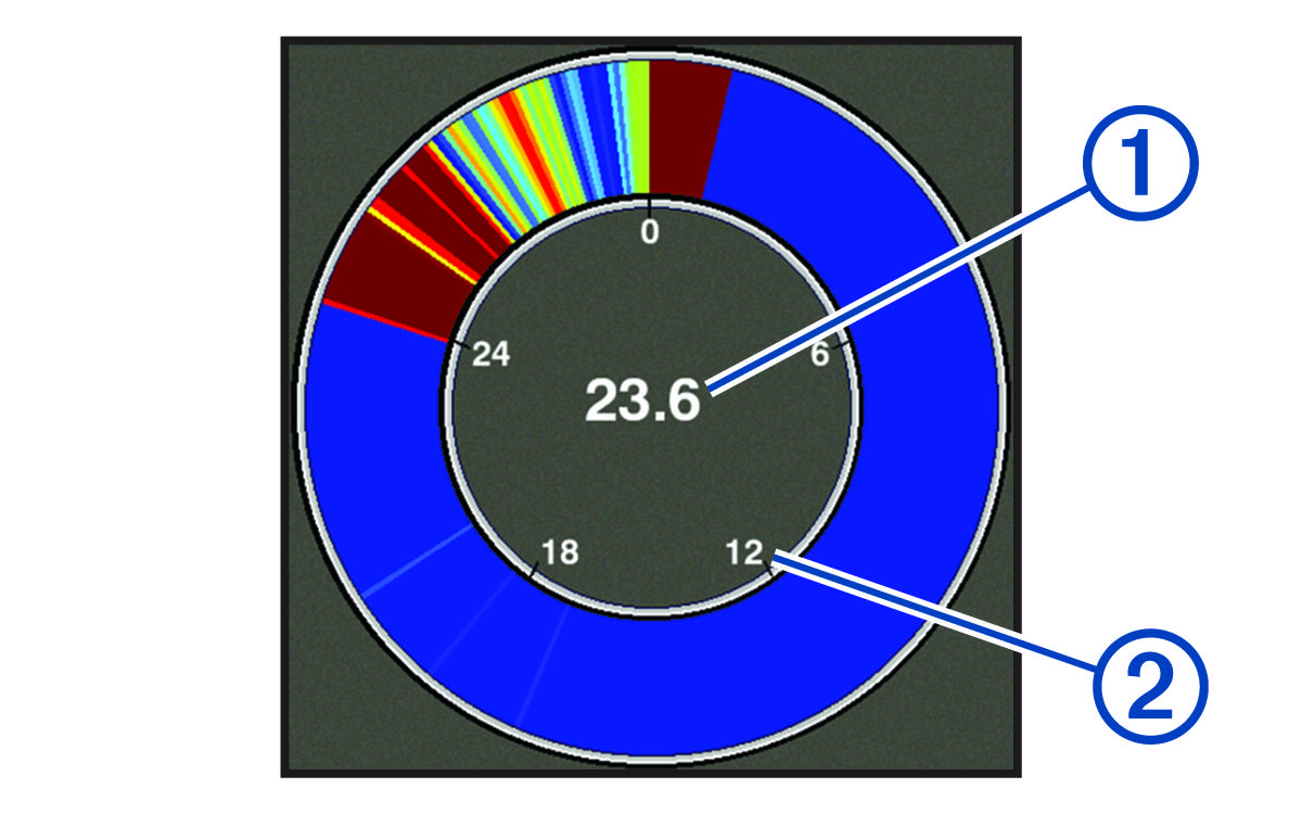

Flasher
The flasher shows sonar information on a circular depth scale, indicating what is beneath your boat. It is organized as a ring that starts at the top and progresses clockwise. Depth is indicated by the scale inside the ring. Sonar information flashes on the ring when it is received at the depth indicated. The colors indicate different strengths of the sonar return.
Select Flasher.
![Flasher with callouts](../Shared/GUID-788B914E-450F-4CE8-880F-1737E56A3452-high.jpg)
Depth at your present location |
Depth scale |
