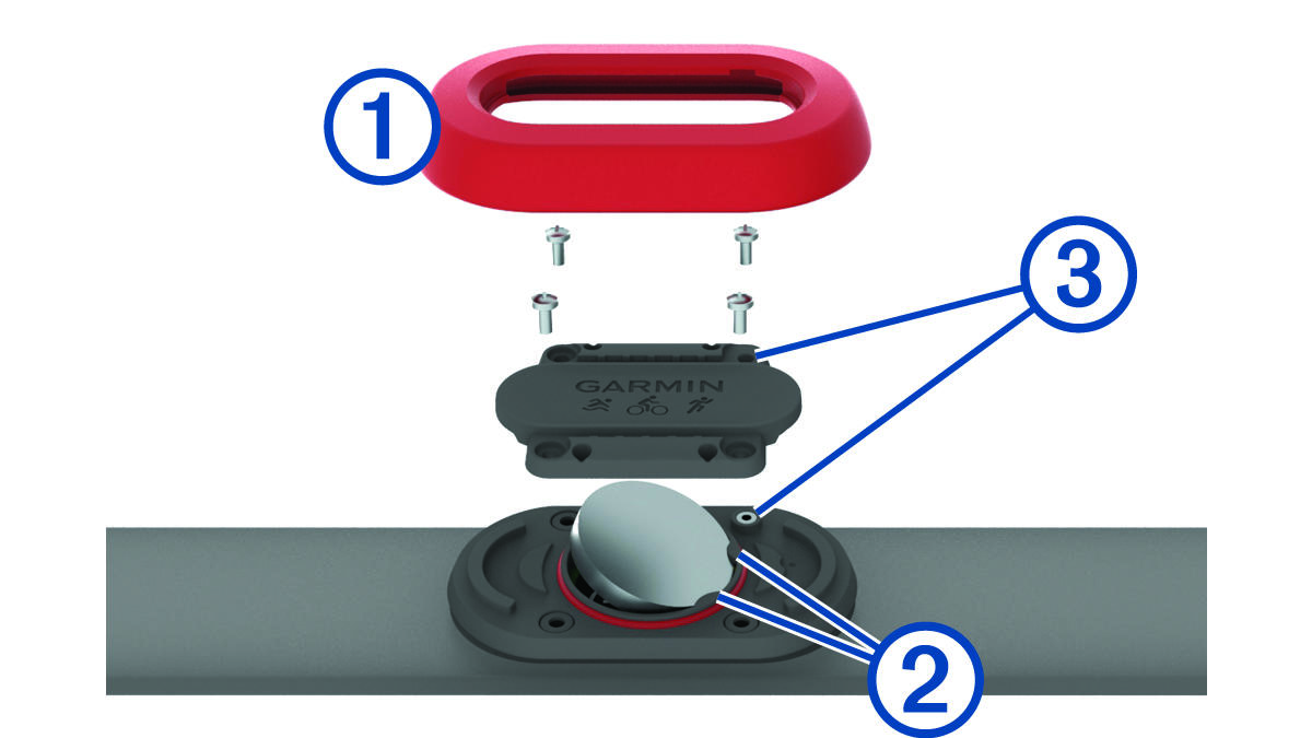

  1. Remove the sleeve Callout number one from the heart rate monitor module.
  2. Use a small Phillips (00) screwdriver to remove the four screws on the front of the module.
  3. Remove the cover and battery.
    Close-up view of the battery being removed with callouts
  4. Wait 30 seconds.
  5. Insert the new battery under the two plastic tabs Callout number two with the positive side facing up.
    NOTE: Do not damage or lose the O-ring gasket.
    The O-ring gasket should remain around the outside of the raised plastic ring.
  6. Replace the front cover and the four screws.
    Observe the orientation of the front cover. The raised screw Callout number three should fit in the matching raised screw hole on the front cover.
    NOTE: Do not overtighten.
  7. Replace the sleeve.
