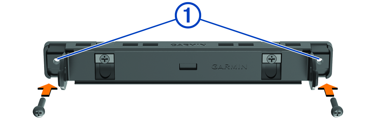

  1. Place the mount base against the mounting surface in the location where you want to mount the camera, and mark the location of the two mounting holes Callout number one using a pencil or other writing instrument.
    You should ensure the mount is level and correctly positioned.
    Surface mount installation with a callout
  2. Remove the mount from the mounting surface, and use a 3.2 mm (1/8 in.) drill bit to drill pilot holes in the two locations you marked.

  4. Place the mount base against the surface, aligning the mounting holes in the base with the drilled pilot holes.
  5. Fasten the mount base to the vehicle using two M4 screws.
    NOTE: The included screws are intended for installation on a vehicle with a fiberglass or plastic shell. You must verify the screws are the correct length and appropriate for the exterior mounting surface of your vehicle. For more information, contact your vehicle manufacturer or a professional installer.
