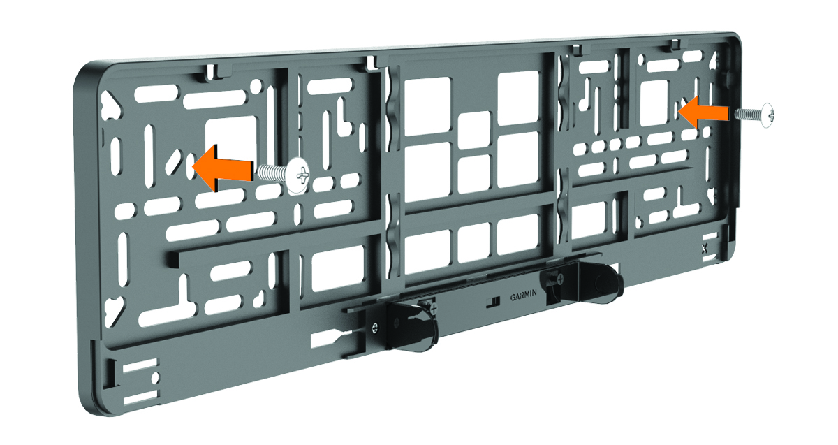

  1. Remove the rear license plate and license plate holder from your vehicle, and retain the license plate screws to install the camera mount.
  2. Place the camera mount against your vehicle, and align the holes in the mount with the license plate mounting holes in your vehicle.
    The camera mount provides a variety of holes and slots for universal vehicle compatibility.
    NOTE: You can install the mount in either orientation. If you are installing the mount with the camera at the top of the license plate, you must remove, rotate, and reattach the camera clip (Installing the Camera at the Top of Your License Plate).
  3. Insert the license plate screws through the mount and into the mounting holes in your vehicle.
  4. Fully tighten the screws.
