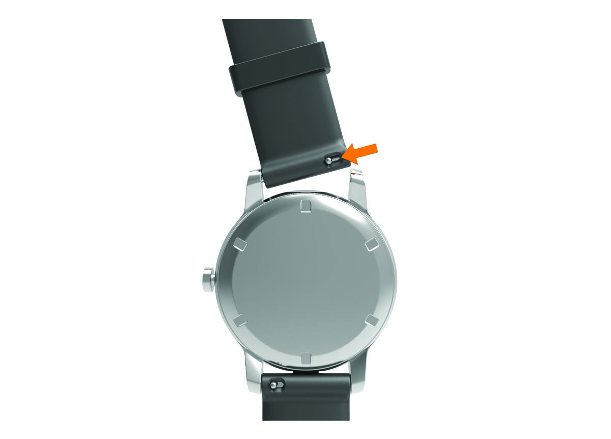

  1. Slide the quick-release pin on the spring bar to remove the band.
    Watch band installation
  2. Insert one side of the spring bar for the new band into the watch.
  3. Slide the quick-release pin, and align the spring bar with the opposite side of the watch.
  4. Repeat steps 1 through 3 to change the other band.
