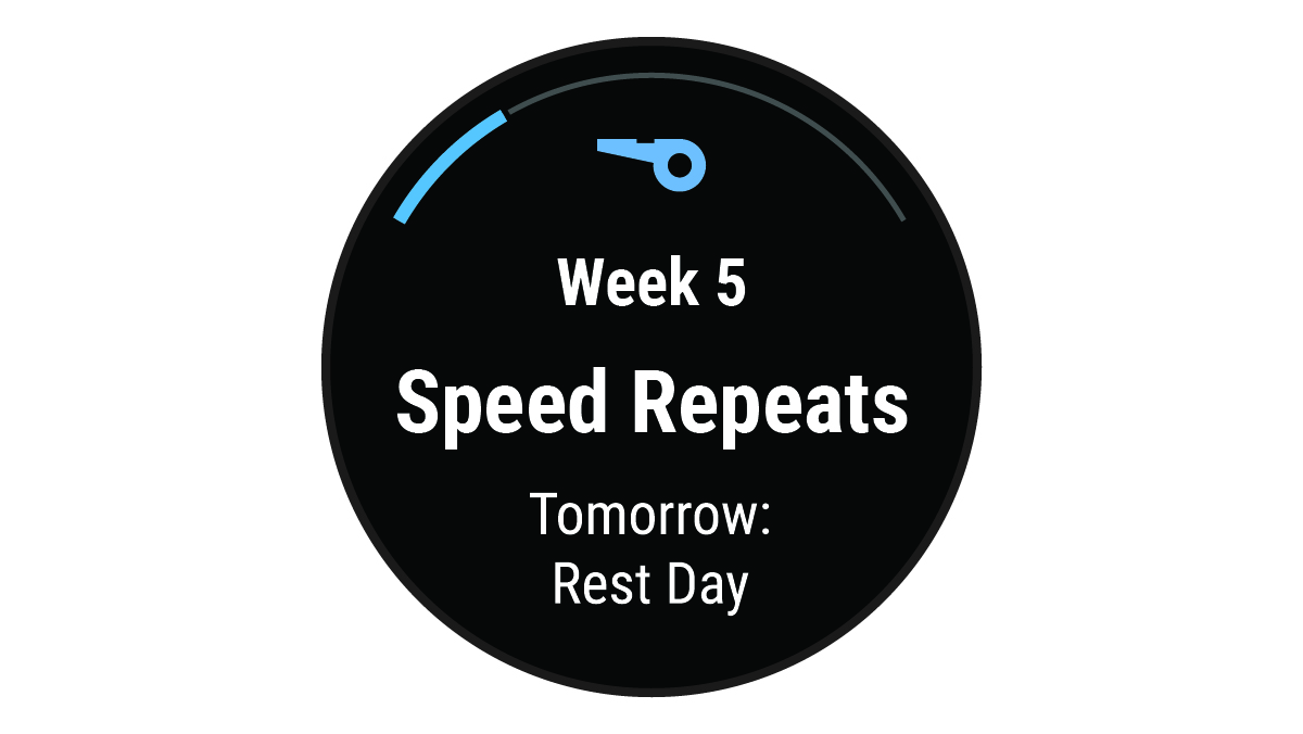

  1. From the watch face, press UP or DOWN to view the Garmin Coach glance.
    If a workout for this activity is scheduled for today, the watch shows the workout name and prompts you to start it.
    Garmin Coach glance
