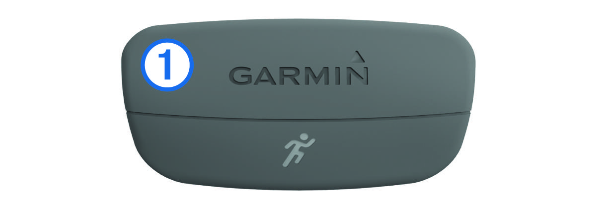

  1. Snap the heart rate monitor module Callout number one onto the strap.
    Close-up view of the heart rate monitor module with a callout
    The Garmin® logos on the module and the strap should be right-side up.
