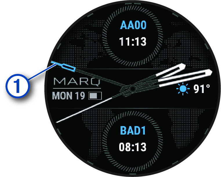

Default Watch Face
NOTE: When you are traveling during a trip planned in the Garmin Connect™ app (Planning a Trip in the Garmin Connect App), the default watch face displays information from the Jet Lag Adviser glance (Using the Jet Lag Adviser).
Watch face with a callout
1
Coordinated Universal Time (UTC) hand. References the 24-hour time markings on the watch.
