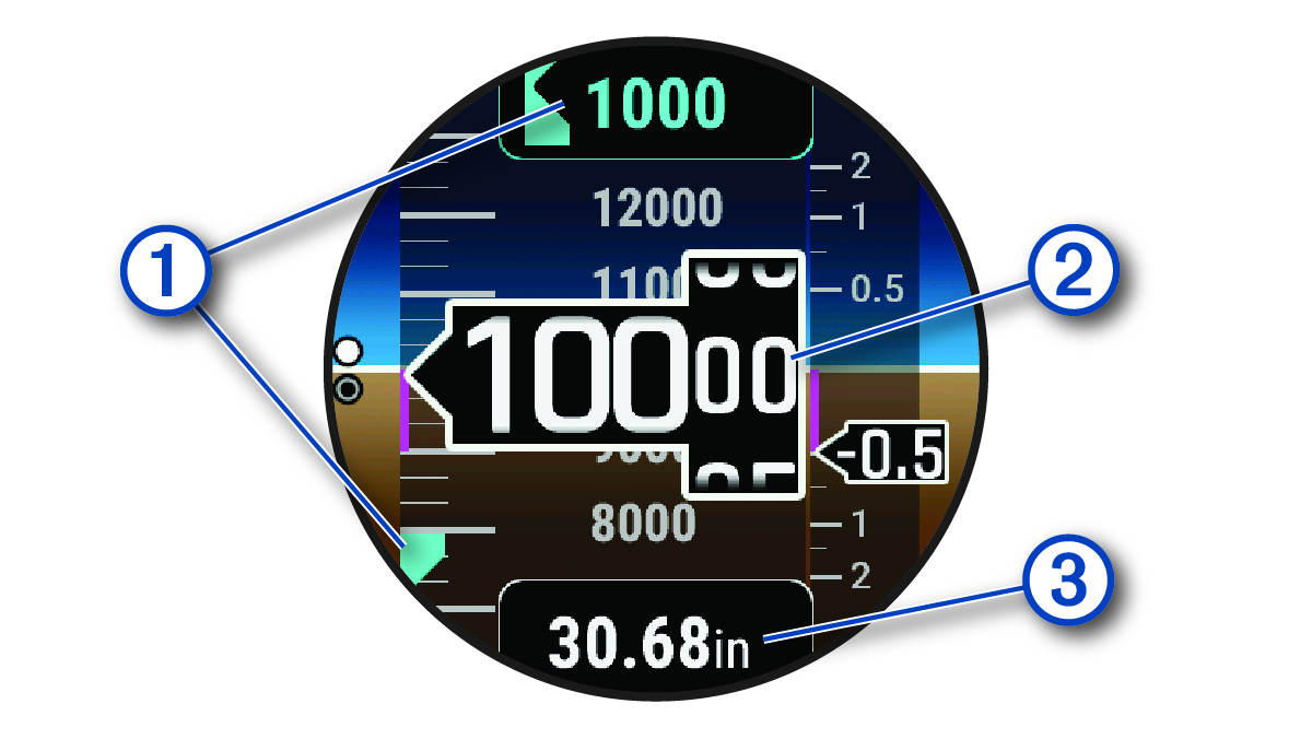

    Altimeter data with callouts
    Callout number 1
    Alert altitude
    Callout number 2
    Pressure altitude
    Callout number 3
    Barometric pressure
