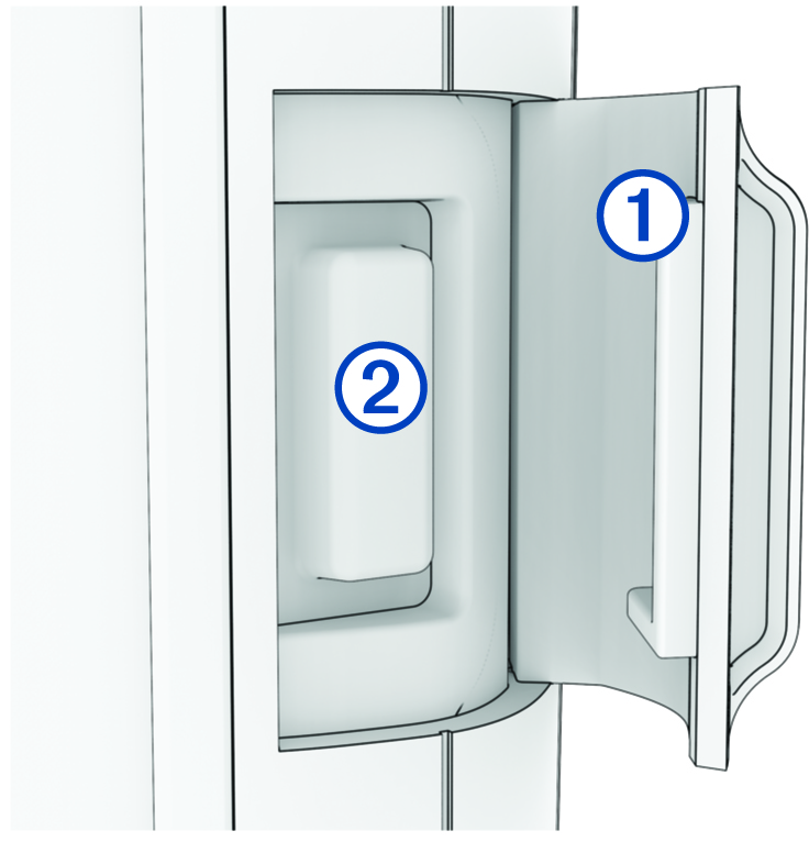

  1. Lift the protective cap Callout number 1 from the SOS button Callout number 2.
    Close-up view of the SOS button and weathercap with callouts
  2. Press and hold the SOS button.
