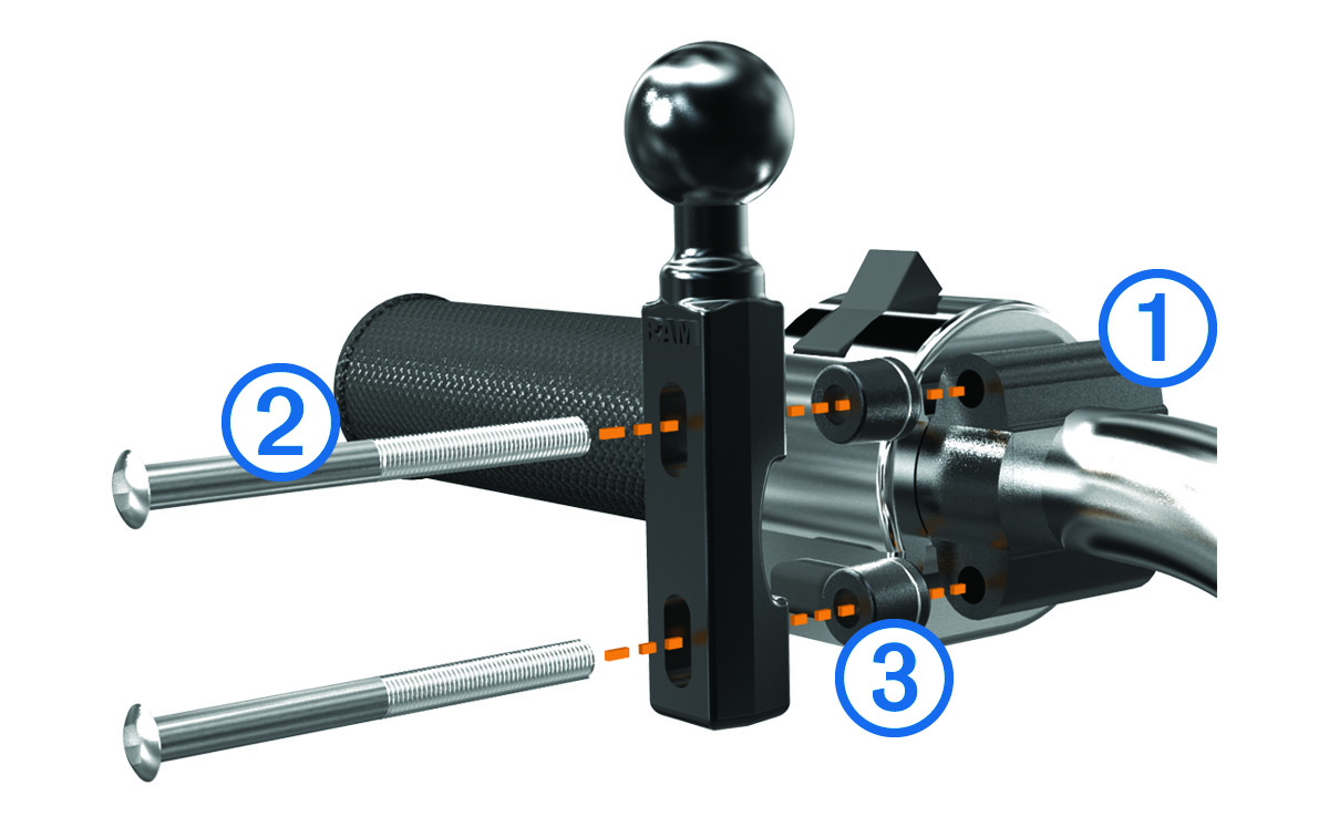

Installing the Handlebar Base to the Clutch-Clamp or Brake-Clamp Brackets Remove the two factory bolts on your clutch-clamp or brake-clamp bracket . NOTE: Both 1/4 in. standard and M6 bolts are included. Match the size of the factory bolts on your clutch-clamp or brake-clamp bracket. Thread the new bolts through the handlebar base, spacers , and clutch-clamp or brake-clamp bracket. Tighten the bolts to secure the base. Parent Topic: Installing the Handlebar Base
