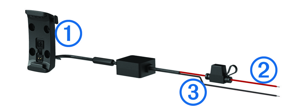

The device must be mounted in a suitable and secure location on your motorcycle, based on available power sources and safe cable routing.
Mount and wiring with callouts
Callout number one
Motorcycle cradle
Callout number two
12 to 24 Vdc system power (red) with in-line fuse
Callout number three
System ground (black)
