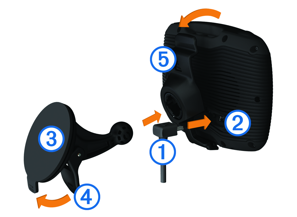

  1. Plug the automotive power cable Callout number one into the port Callout number two on the mount.
    Mounting diagram with callouts
  2. Remove the clear plastic from the suction cup Callout number three.
  3. Clean and dry your windshield and the suction cup with a lint-free cloth.
  4. Press the suction cup to the windshield, and flip the lever Callout number four back toward the windshield.
  5. Snap the cradle Callout number five onto the suction cup arm.
  6. Fit the bottom of your device into the cradle.
  7. Tilt the device back until it snaps into place.
  8. Plug the other end of the automotive power cable into a power outlet.
