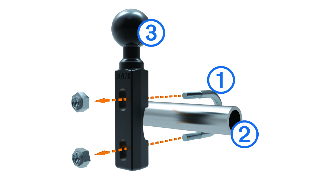

Installing the U-bolt and Handlebar Base Place the U-bolt around the handlebar , and thread the ends through the handlebar base . Tighten the nuts to secure the base. NOTE: The recommended torque is 50 lbf-in (5.65 N-m). Do not exceed torque of 80 lbf-in (9.04 N-m). Parent Topic: Installing the Handlebar Base
Installing the U-bolt and Handlebar Base Place the U-bolt around the handlebar , and thread the ends through the handlebar base . Tighten the nuts to secure the base. NOTE: The recommended torque is 50 lbf-in (5.65 N-m). Do not exceed torque of 80 lbf-in (9.04 N-m). Parent Topic: Installing the Handlebar BaseHomeInstallationMounting Your Device in a MotorcycleInstalling the Handlebar BaseInstalling the U-bolt and Handlebar Base
