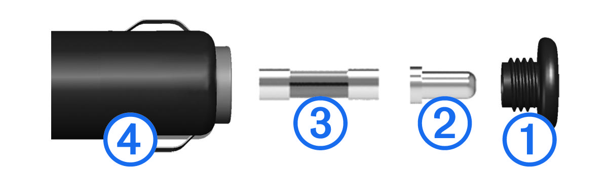

If your device does not charge in your vehicle, you may need to replace the fuse located at the tip of the vehicle adapter.
  1. Rotate the end piece Callout number one counter clockwise to unlock it.
    Vehicle adapter and fuse with callouts
    TIP: You may need to use a coin to remove the end piece.
  2. Remove the end piece, the silver tip Callout number two, and the fuse Callout number three.
  3. Insert a new fast-blow fuse that has the same current, such as 1 A or 2 A.
  4. Place the silver tip in the end piece.
  5. Push in the end piece and rotate it clockwise to lock it back into the vehicle power cable Callout number four.
