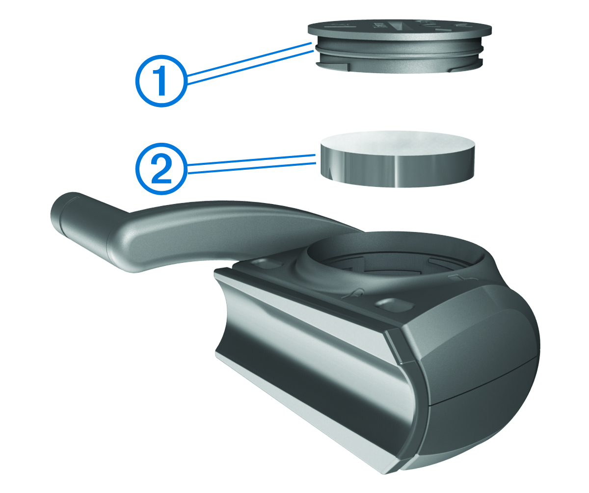

  1. Locate the circular battery cover Callout number one on the side of the GSC™ 10.
  2. Use a coin to twist the cover counter-clockwise until it is loose enough to remove (the arrow points to unlocked).
  3. Remove the cover and the battery Callout number two.
  4. Wait 30 seconds.
  5. Insert the new battery with the positive side facing up.
    NOTE: Do not damage or lose the O-ring gasket.
  6. Use a coin to twist the cover clockwise back into place (the arrow points to locked).
After you replace the GSC 10 battery, you must pair the GSC 10 with the device again.
