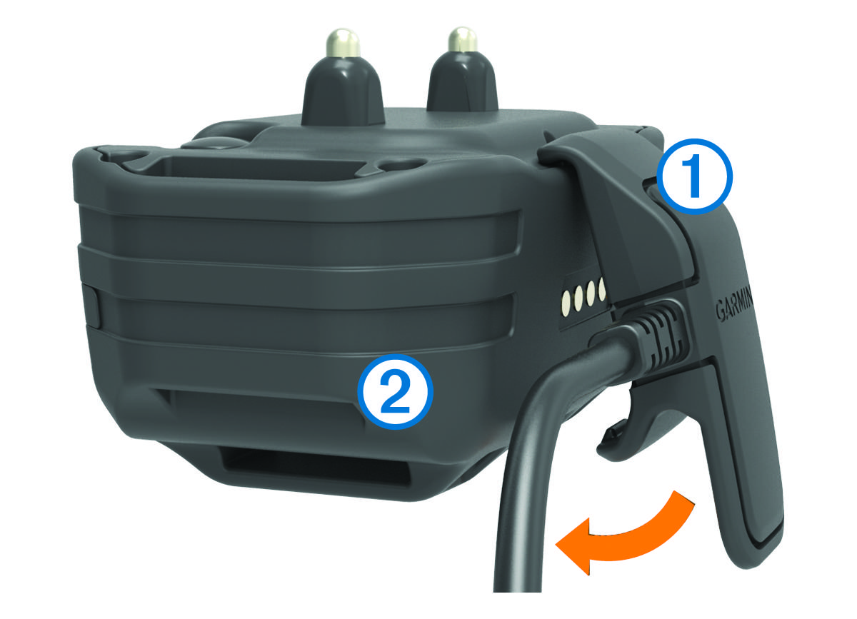

  1. Snap the charging clip Callout number one onto the device Callout number two.
    Diagram of the charger attaching to the dog collar device with callouts
  2. Plug the power cable into a power source.
    The status LED is solid red when the collar is charging.
  3. After the status LED turns solid green, remove the charging clip from the collar.
