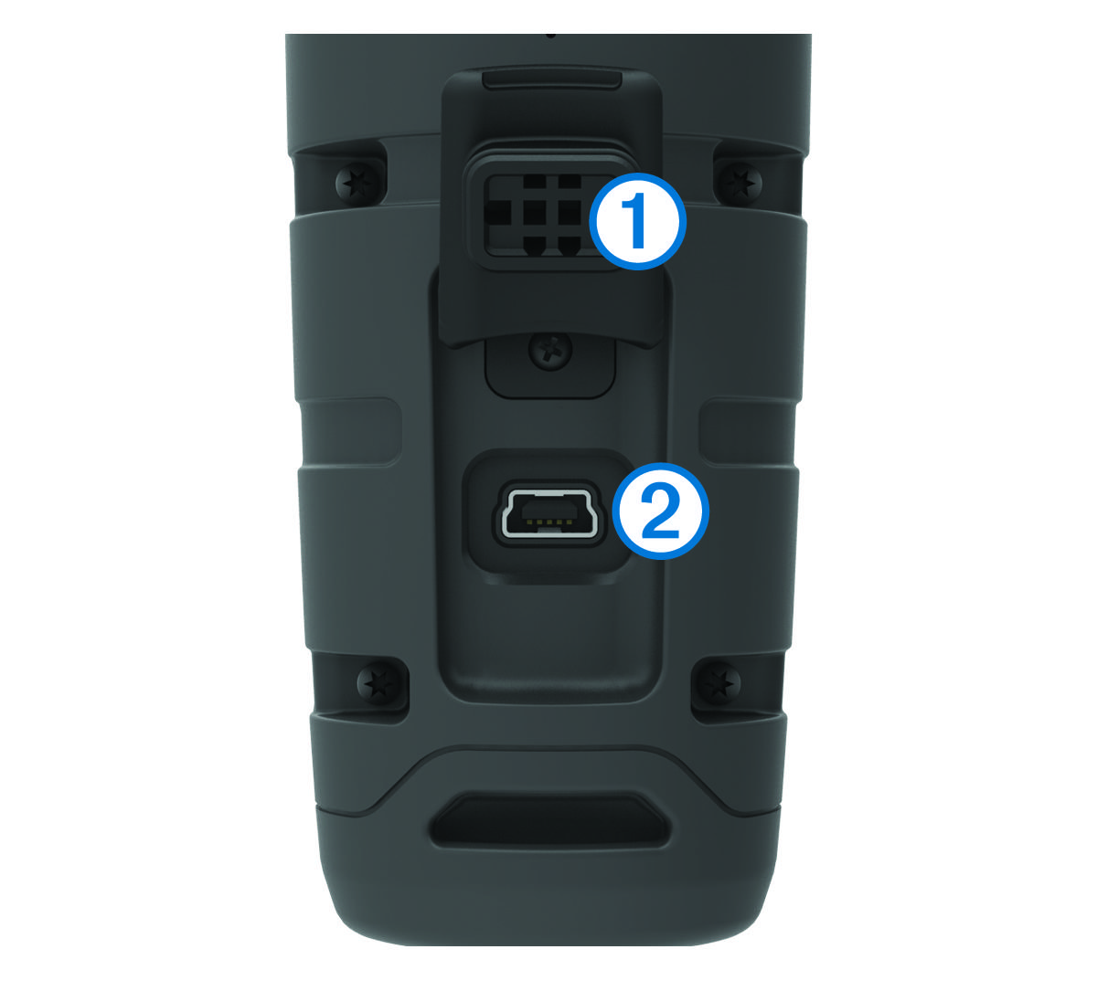

  1. Lift the weather cap Callout number one.
    Close-up view of the charging port and weather cap with callouts
  2. Plug the small end of the power cable into the mini-USB port Callout number two on the device.
  3. Plug the other end of the power cable into an appropriate power source.
    The status LED is solid red when the device is charging.
  4. After the status LED turns solid green, unplug the power cable from the device.
