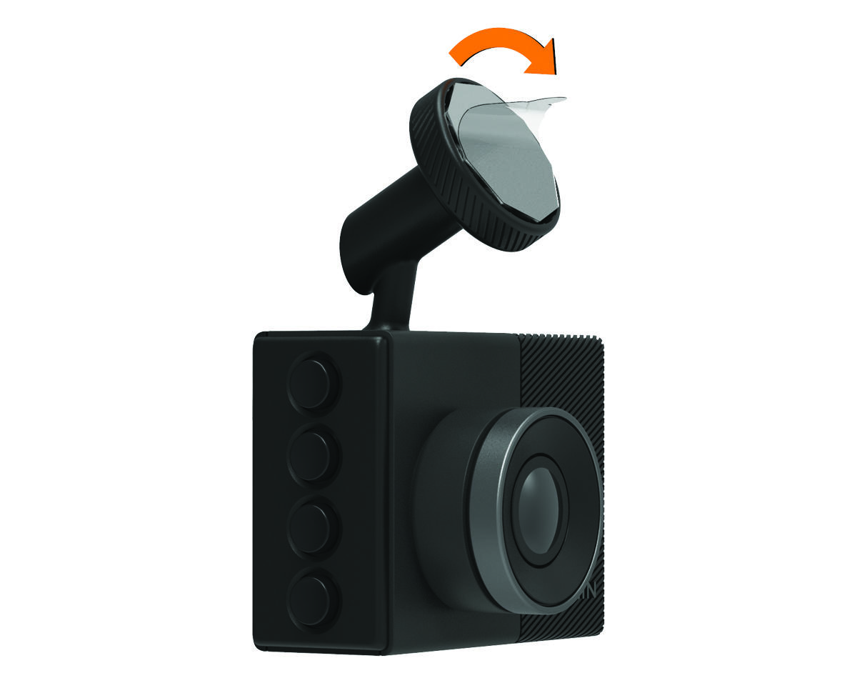

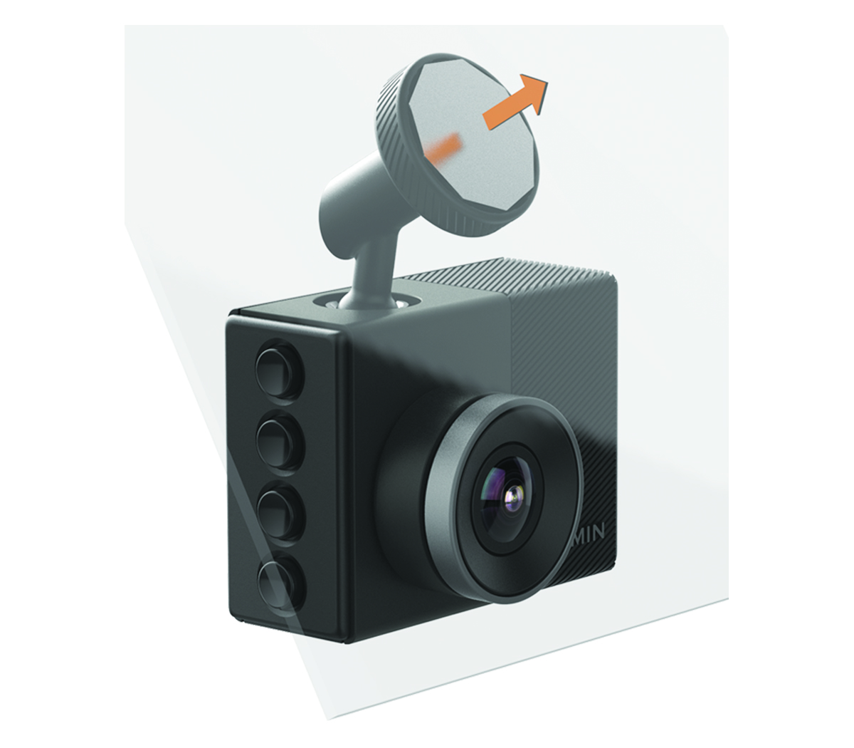

Installing the Mount onto Your Windshield
The adhesive mount is extremely difficult to remove after it is installed. You should carefully consider the mounting location before you install the mount.
Before you can install the adhesive mount onto your windshield, the ambient temperature must be from 21° to 38°C (from 70° to 100°F).
TIP:
You can connect the device to power and hold the device in the preferred mounting location to check the camera's field of view at that location.
