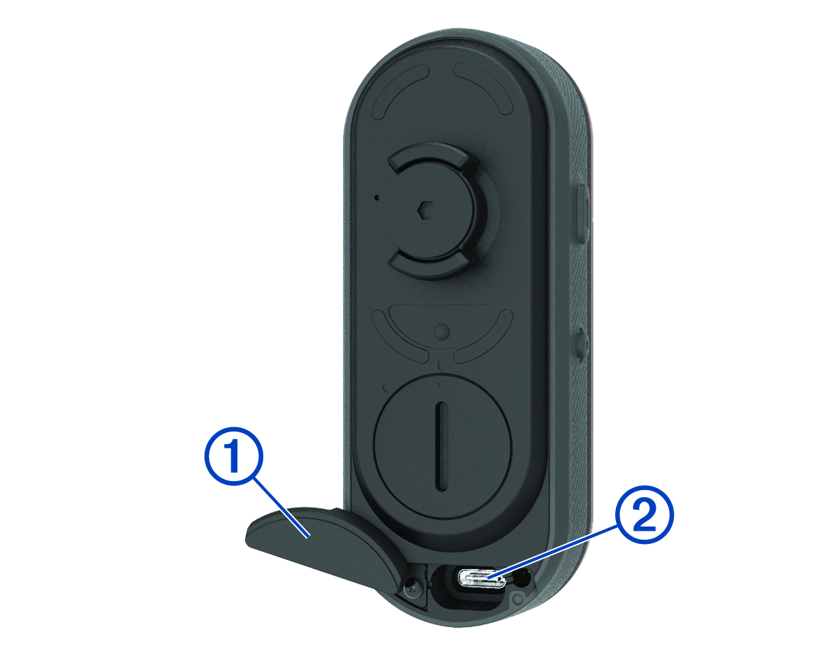

  1. Pull up the weather cap 1 from the USB port 2.
    Back view of the device with callouts
  2. Plug the small end of the USB cable into the USB port on the device.
