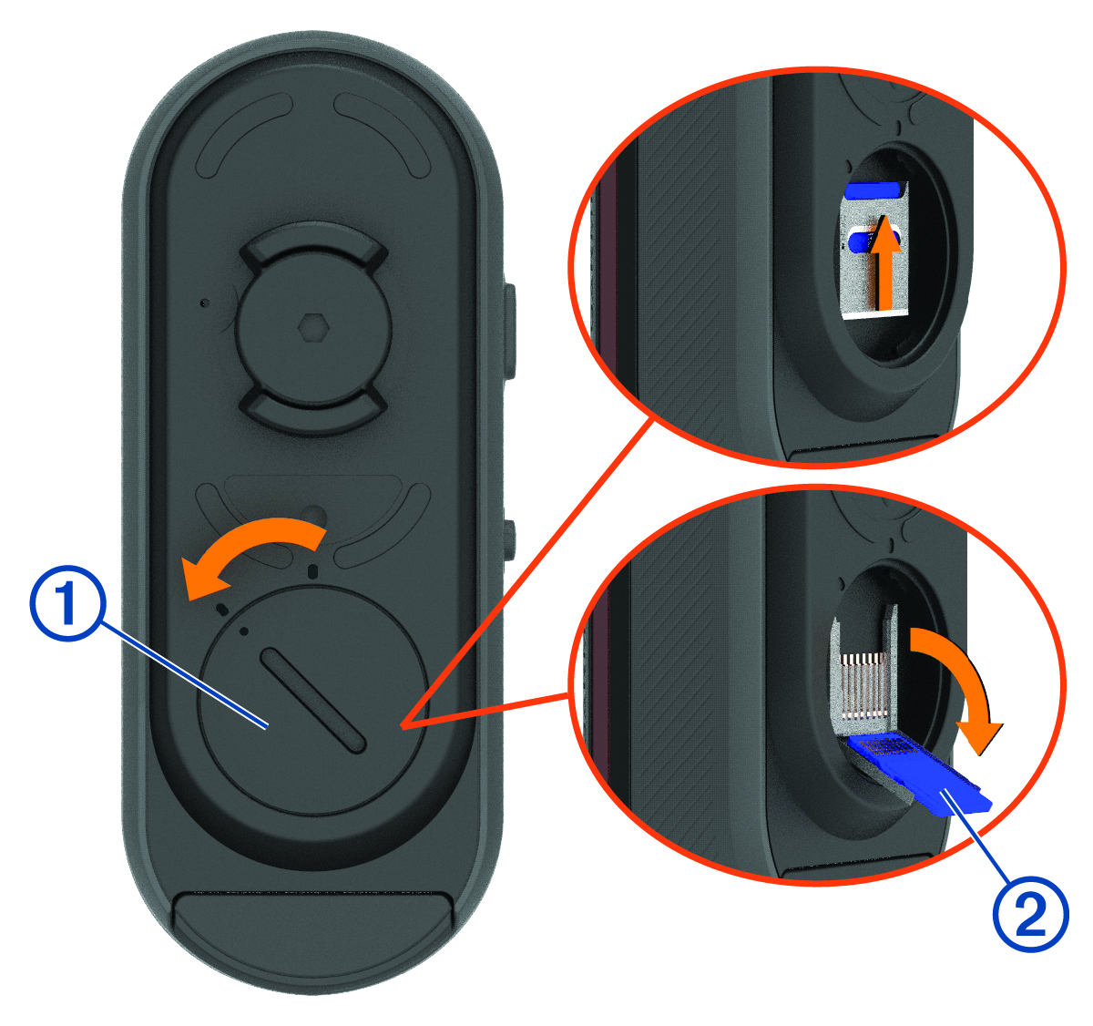

  1. Open the cover 1.
    Memory card installation with callouts
  2. Slide the card holder toward the mount, and lift up.

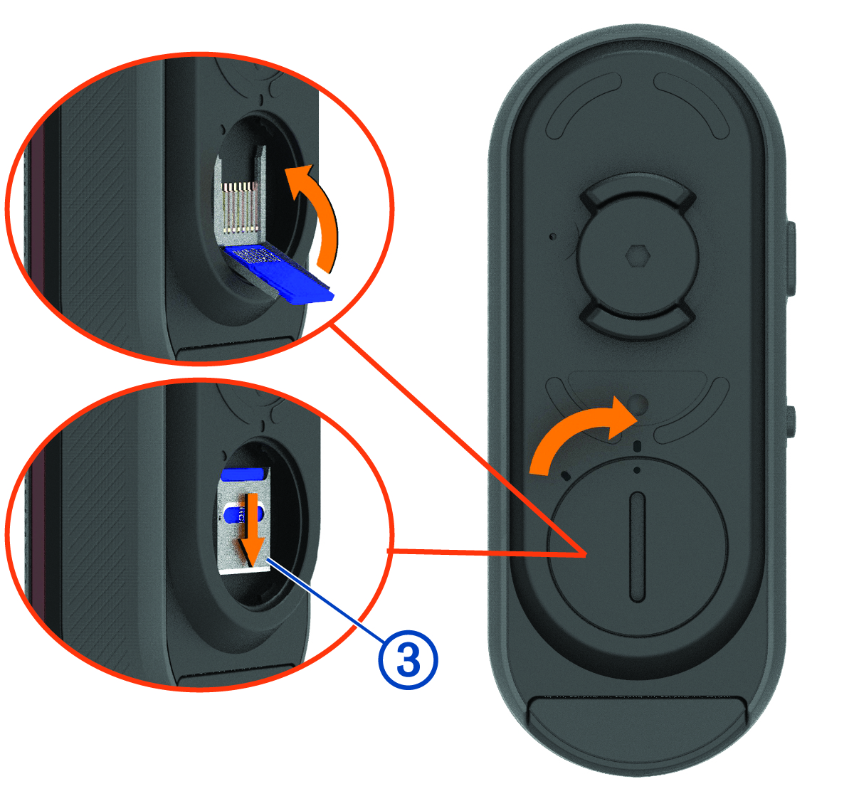

  3. Pull open the card holder 2.
  4. Insert the memory card into the memory card slot with the contacts facing the device.
  5. Close and latch the card holder 3.
    Memory card installation with a callout
  6. Close and latch the cover.
