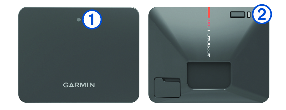

LED Statuses
The status LED 1 indicates the device status. The charge LED 2 indicates the battery status.
Front and back views of the device with callouts
1 Status LED Activity
Status
Solid blue
The launch monitor is in pairing mode.
Flashing blue
The launch monitor is reconnecting to the previously connected phone.
Solid white
The launch monitor is in mass storage mode.
Flashing white
The launch monitor is in standby mode.
Flashing green
The launch monitor is ready for a shot.
Solid red
The launch monitor is busy.
Flashing red
An error occurred. To resolve the error, reset the launch monitor. If that does not resolve the issue, go to support.garmin.com.
Flashing purple
A software update is in progress.
2 Charge LED Activity
Status
Flashing red
The battery is charging.
Solid red
The battery is fully charged.
Rapidly flashing red
The launch monitor is unplugged and the remaining battery power is low.
NOTE: The LED flashes rapidly for five seconds after the launch monitor is turned on if the battery is low.
