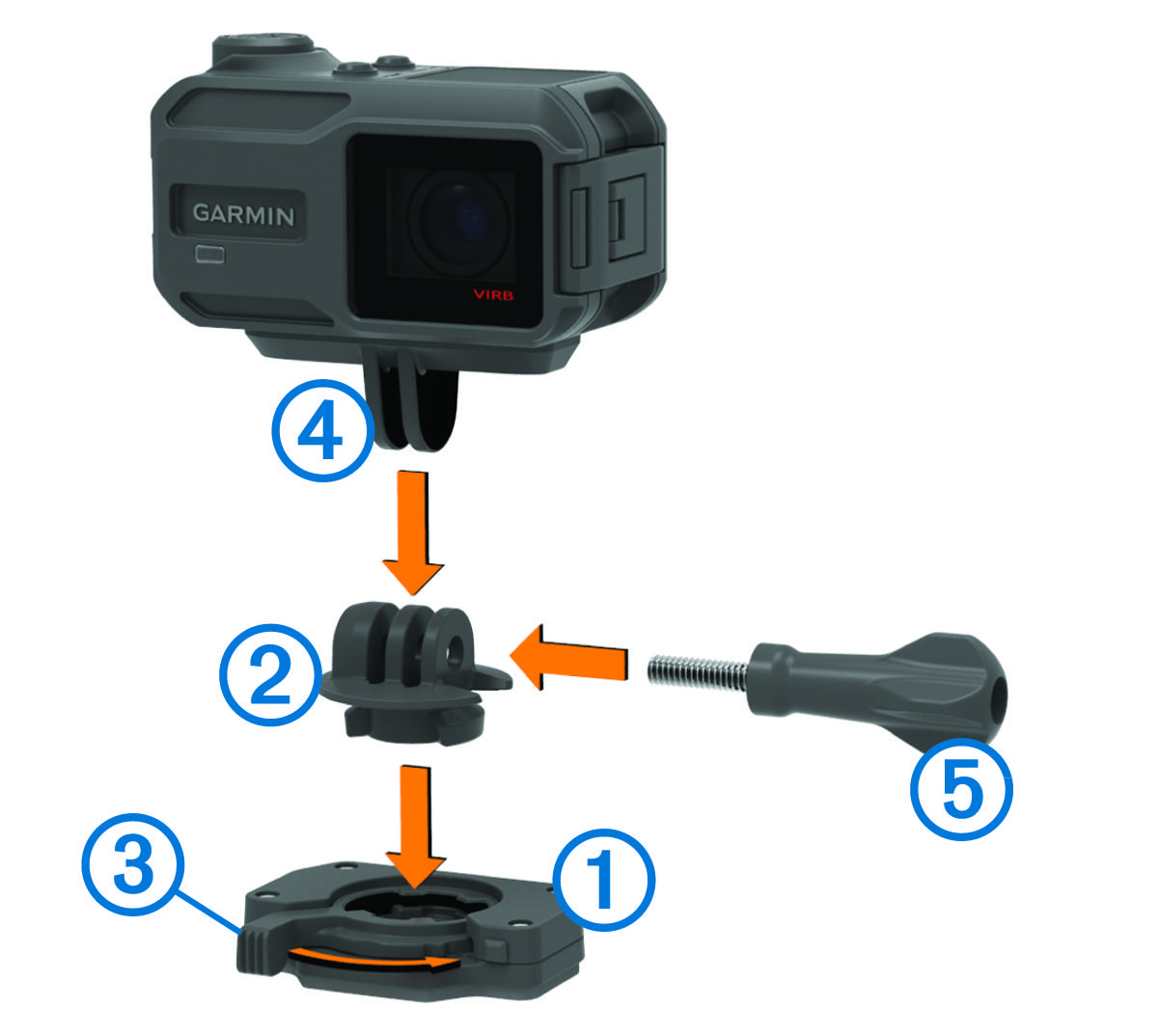

Attaching the Device to the Mount
To prevent product loss or damage, do not use the adhesive mounting base when the temperature is below -15°C (5°F).
The permanent mounting adhesive is extremely difficult to remove after it is installed.
Before you can install the adhesive mounting base onto a surface, the ambient temperature must be from 21° to 38°C (from 70° to 100°F).
Your device includes an assortment of mounting bases and arms, which can be used in many configurations. These instructions provide an example of one possible configuration. You can also purchase additional mounts for your device, such as wearable mounts, vehicle mounts, or a tripod mount. Go to www.garmin.com/VIRB for more information.
NOTE:
By default, the device should be mounted with the screen facing up to record correctly oriented video. You can adjust the settings to record with the screen facing down (Inverting the Camera Orientation).
