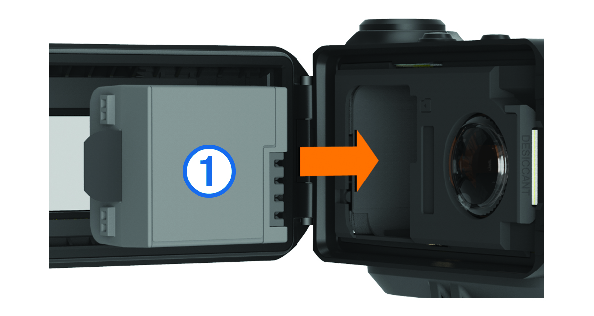

  1. Open the front cover.
  2. Locate the metal contacts on the end of the lithium-ion battery.
  3. Insert the battery Callout number one into the compartment, contacts first.
    Battery compartment and battery with callout
  4. Press the battery into place.
  5. Close and latch the front cover.
