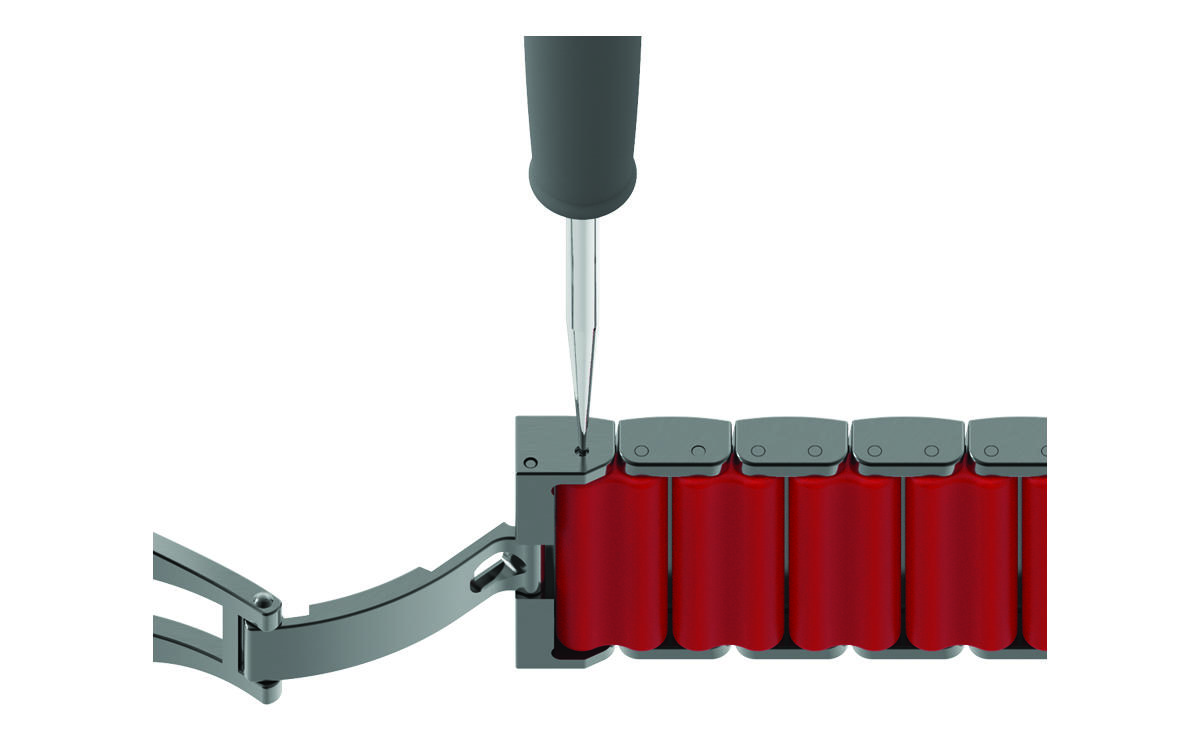

Garmin® recommends you take your watch to a jeweler or other professional to adjust the length of the metal bracelet.
  • Use a pin removal tool or spring bar removal tool to adjust the bracelet.
    Spring pin band adjustment

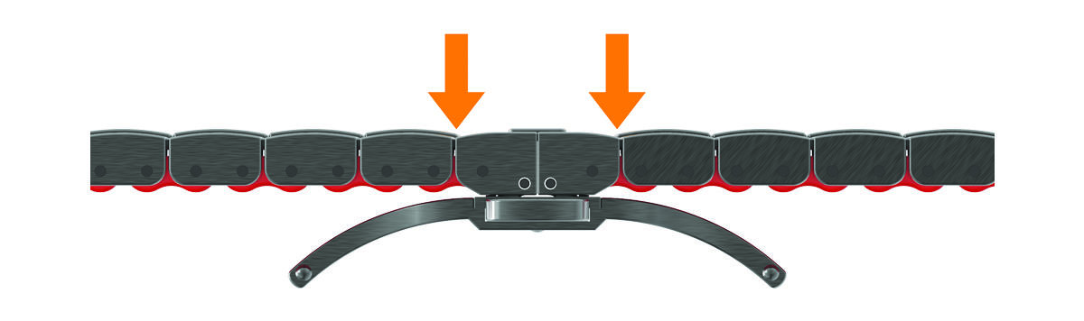

  • Remove an equal number of links from both sides of the clasp.
    This helps your watch stay centered on your wrist.
  • Add +1 mm links for micro adjustments.
    For a balanced look, you should add +1 mm links starting from the clasp on alternating sides, instead of adding links to the ends of the bracelet. The +1 mm side of the links should face the inside of your wrist.
