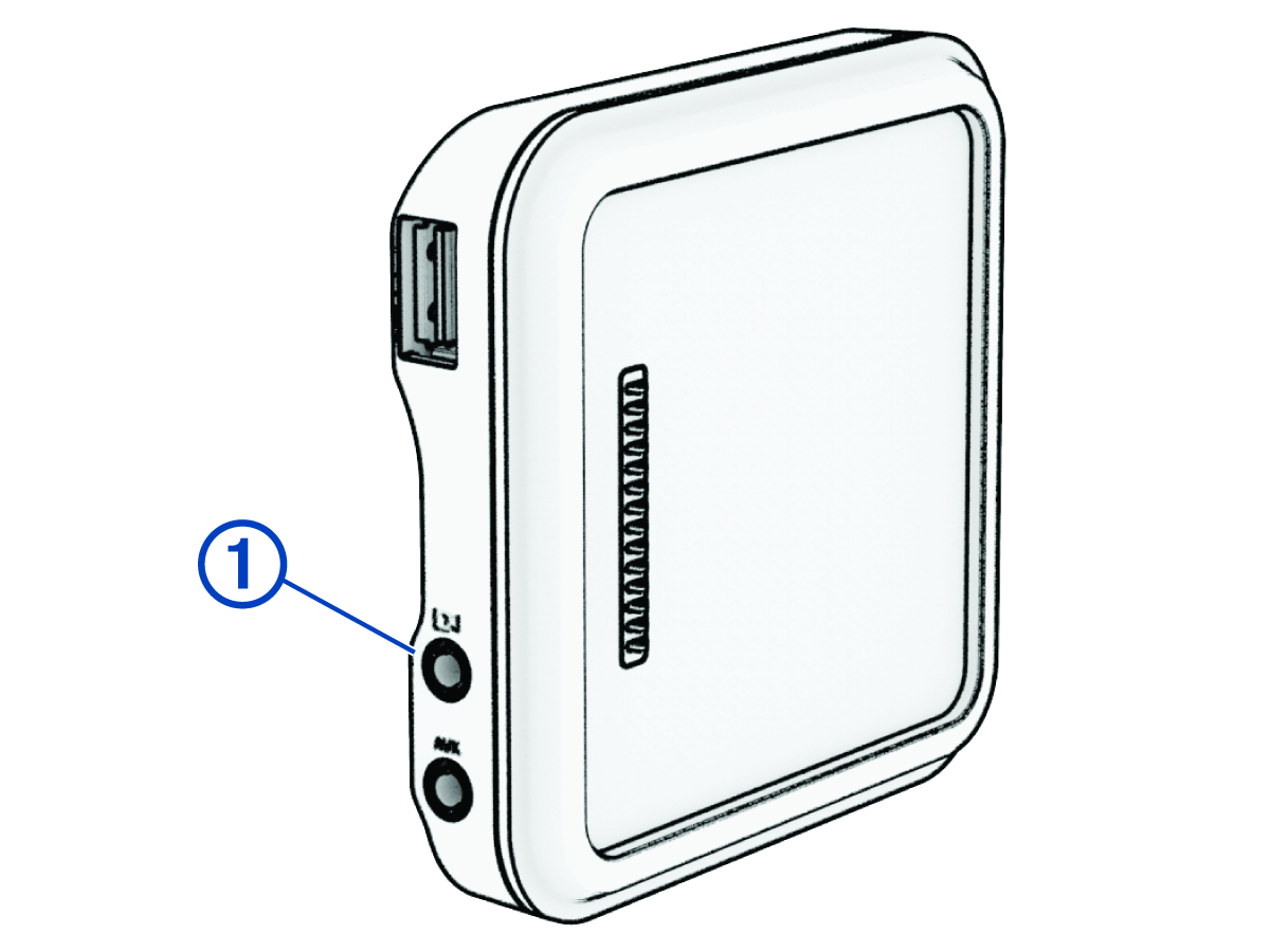

To connect a wired backup camera, you must use a magnetic video mount accessory (sold separately), which includes a 3.5 mm composite video input jack. Go to garmin.com to purchase an accessory mount.
You can connect a wired backup camera and view the output on the device screen.
  1. Replace the original device mount with the video mount accessory.
  2. Insert the camera video cable plug into the video input jack 1 on the mount.
    Video input jack with a callout
