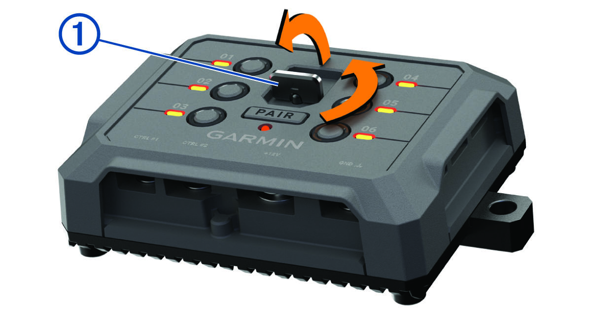

  1. Lift the front cover latch Callout number 1 and rotate it counter-clockwise.
    Front cover latch rotating with a callout

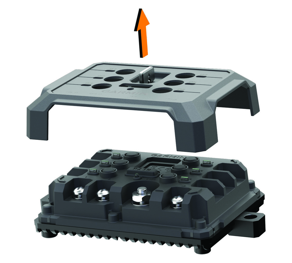

  2. Pull the front cover off of the device.
    Front cover removed from the device
